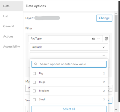

It seems like you only want/need to focus on invasive species - can you filter out the data you don't care about in your web map, or is this data being pulled in via stand-alone layer?  Do you need to show/access all 93 million+ observations in the dashboard at any time?  If you need all records in the dashboard you may try filtering the unwanted data out via a Category or Feature URL parameter, filtering against your list and map elements, and encoding spaces in the URL.
https://community.esri.com/t5/arcgis-dashboards-questions/arcgis-dashboard-url-parameter-what-is-it/...
https://doc.arcgis.com/en/dashboards/latest/create-and-share/url-parameters.htm
https://doc.arcgis.com/en/dashboards/latest/create-and-share/configuring-actions-on-url-parameters.h...
UPDATE:   or set a Filter on the Data tab of the List element?
MinaNada
 @ToddW_stl I appreciate you sharing these really insightful links. We don't need access to all of these observations. After looking through those resources, I found a way to filter them from the web map itself. I will keep these URL parameters in mind as I'm building out the rest of the dashboard. Thanks!
