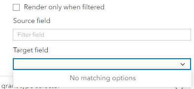

Hi all! I have a dashboard that displays crime incident locations. I have a category selector that works perfectly. I would like to add a Date Selector so that users can select a date and view the incidents from that day.
When I add a Date Selector, the interface says "No Target Field" to pick a date from. The layer with the crime incidents does have a Date field, and when I view the layer in the map viewer, the interface does in fact recognize the field and that it is formatted as a date.
Any thoughts? I'm at a loss!

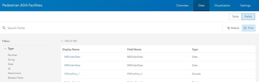

In Portal / AGOL, you can go to your hosted feature layer and look at the Data section and field information. You should see the word Date as the field type:

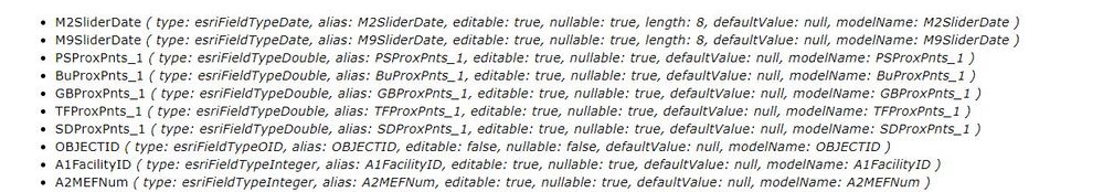

Alternatively, you can go to the REST endpoint of the service and confirm it the same way:

Same thing is happening to me. The fields say that they are a Date type, yet they don't appear as an option. Did you ever find a resolution?
rogue_recon
This is happening to me, too. I made sure to create it as a Date field and it's not showing up in Target Field for the date selector. Does anyone find a fix for this?
hisemdervis
 me too, I can't find the date field
SönkeMaatsch
We had the same issue. After changing the field type from date to timestamp, it worked.
