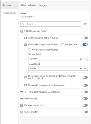

I have a list in my dashboard based on a data expression that counts the number of locations with the same address, then I use advanced formatting to color the background of list item based on the frequency that address occurs in my data source. I can then filter the map when a list item is selected, but the map will not also zoom to the location. Is there a way to make this happen?

Hi @clt_cabq,
What map actions have you set on the list. If you set it to filter by the same field and also set it to zoom in then it should zoom in. There could be the possibility that there could be an error in one of the addresses which might also affect the filter and zoom.
clt_cabq
When I have it set up as I do, the only action that is available is the Filter option. The list is based on the same layer in the map so its sort of two instances of the same object.

Hi @clt_cabq,
Is your data able to be filters correctly based on the list. If it is able to filter but not zoom then one thing you can try is to create a new featureset in the data expression and use that to filter.
