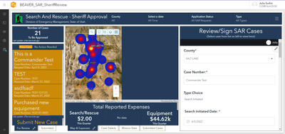

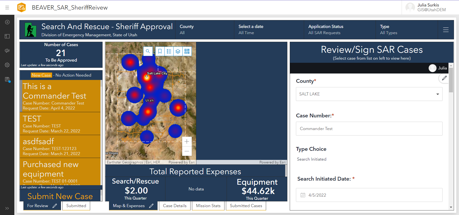

Hello, I'm having issues adding a second map to my dashboard -- the map works in map viewer, but when I add it to the dashboard it just shows up completely blank (it's supposed to be just right of the map that's showing up below). I actually won't need to have two maps in the final version, but for multiple dashboards I'm swapping the maps and layers, which would be way easier than recreating the whole dashboard, or deleting the map and adding the new one (which breaks the widgets with dependancies).

It turns out it is because the maps were never officially "saved." I created the maps using the API for python, but didn't include a save function -- so they existed but couldn't be added.
