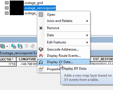

I am just right clicking the table in the ArcMap table of contents and selecting display x,y events
then I publish it as a map service. So, on the Portal side I end up with a "Map Image Layer"

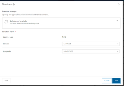

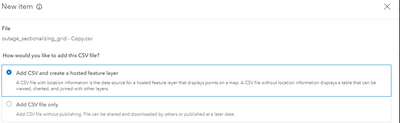

This process for me was:
Add csv to Online by hand and create a hosted feature layer:
Then update with a python batch job.
This is my simple proof of concept script (I have the full dev one as well if you want to see it - the prototype might be faster to digest):
