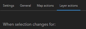

1. On your map widget, choose Configure:
2. Go to Layer Actions
3. Find the layer that will be affected by the selection and choose Filter:
4. From here you can change what elements get filtered out based on the map selection:
Under Add Target, choose your elements
5. After hitting "Done" and going back to the map, you will see a selection option at the top left corner that you can drop down and choose how you want to select your objects
6. Perform the selection and then watch the 'action' element change!
7. To clear the selection, press the X next to the selection number:
