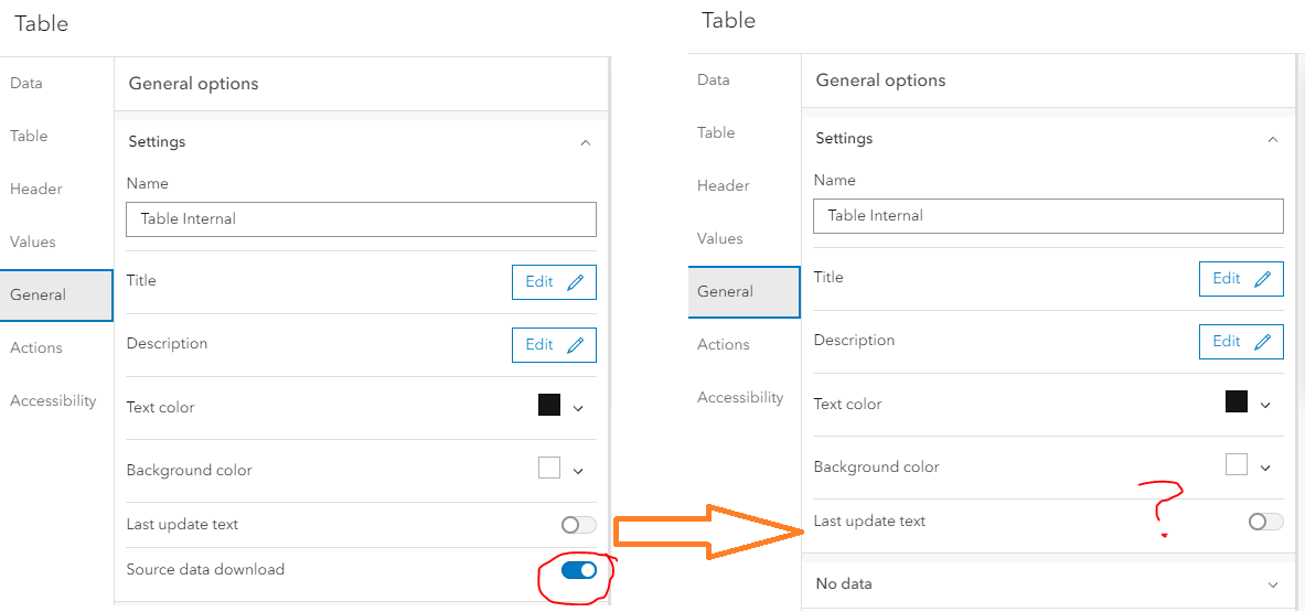

I can get the source data download from a layer, but not a data expression (same hosted layer in ArcGIS online). Why is this not allowed? It would really help me as the data expression cleans up several fields nicely, but I can't have users download the data without this. Frustrating.

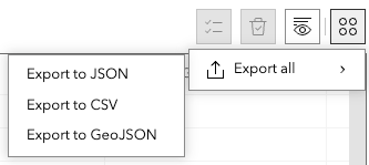

I ended up using an Experience, where the user can export the table to csv. It's too bad because I think the dashboard version of what I'm doing looks better, but the Experience handles the data better. 😕
