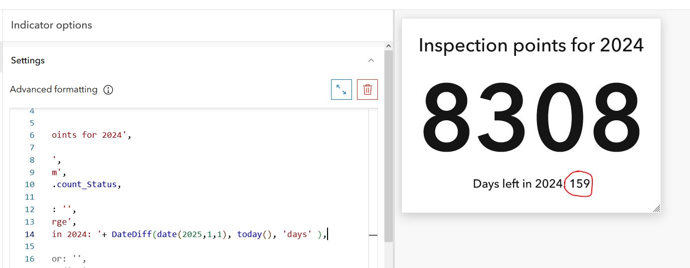

I am trying to get a simple count of days till the end of the year and for some reason Arcade is not preforming calculations with Today() like I am expecting.
When I use the code :
DateDiff(date(2025,1,1), date(2024,8,26), 'days' ) -> I get 128 days
But when I use the code:
DateDiff(date(2025,1,1), date(today()), 'days' ) -> I get 159 days
I am using the advanced formatting window on an indicator in a dashboard.
Is there something obvious I am missing here? Why would the today() function add 30 extra days?

jcarlson
MVP Alum
In the function Date, the second parameter is the month number, but it's zero-indexed. Meaning 0 = January, etc. So 8 is September.
- Josh Carlson

ChrisUnderwood
You might also be able to utilise the ISOMonth function which offers "Values range from 1-12 where January is 1 and December is 12."
https://developers.arcgis.com/arcade/function-reference/date_functions/#isomonth

LindseyGreidanus
Thank you!
