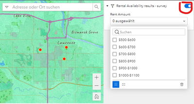

The problem is that the Dashboard can only filter by equality: rental_amount_layer = rental_amount_selector
But if you select "$500-$600", the dashboard can't find features to show, because the values in the layer are built like "$500-$600,$600-$800,$1000-$1100".
What you need is a LIKE filter, which doesn't seem to exist in Dashboard.
So, you've got (at least) two options:

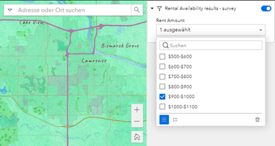

If you have to use Dashboard, you need to reconfigure your layer to only show the separate rental amounts (many points at the same location). This way, you can even skip the data expression and build the category selector based on the layer.

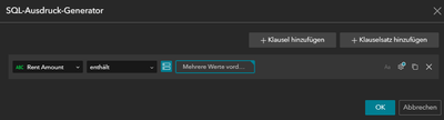

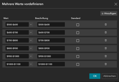

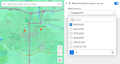

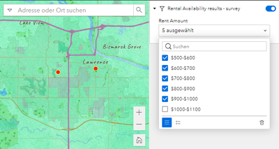

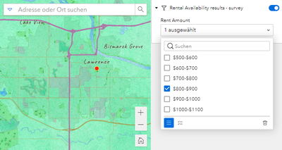

If you don't have to use Dashboard, you can easily achieve this with an Experience. Add your map and a Filter widget, set the filter query to "Rent Amount - includes - predefined values", and define some categories.
And then you can select the amounts you want to filter:
JohannesLindner_2-1677657255864.pngJohannesLindner_3-1677657270640.pngJohannesLindner_4-1677657292102.pngJohannesLindner_5-1677657307507.pngJohannesLindner_6-1677657330622.png

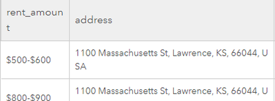

ScoutStanley
Yes! That is exactly what I was trying to go for! Much appreciation 😁  and thank you for helping me understand the expression!

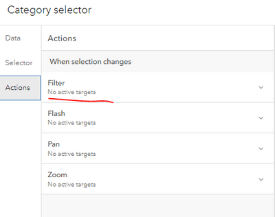

ScoutStanley
I tried doing it by "Grouped Values". However, when I do that it doesn't work with the geometry within the map or the other widgets. And it doesn't save my actions for filters. The image below is what it looks like after I reopen the widget to see if it saved my active targets. So how do I get it to filter the map and other widgets? or is this a bug?
