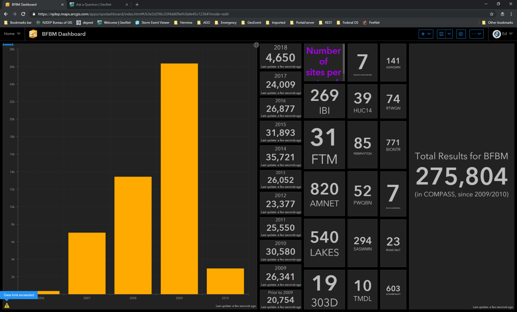

Hi,
Trying to set up a serial chart parsed by year from a table with 275K rows, however the chart is not displaying all results and is giving a data limit exceeded error.  Is there a limit to the number of rows which can be displayed in the chart? Other widgets such as the indicator return all rows.  Any advice?
Thanks,
Ed
