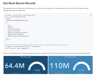

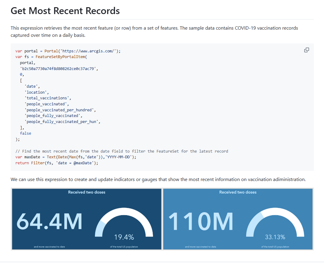

This code is based on this github post I had found

The dataset in the Github repository example has that date in a text field, not a date field. If your field is a date field, you can do this much easier using the OrderBy and First functions

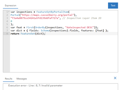

Thank you for your prompt response! I tested it and it appeared to work till I clicked done and then got this.

Ah, I forgot the first rule of Data Expressions...always return a FeatureSet.
This should work
