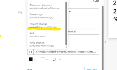

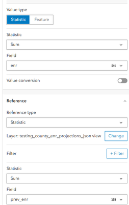

The indicator works as expected: It sums up curr_enr and prev_enr values in the Data section. In the Indicator, section, I choose "Percent Change" calculated values (images below.) I get the correct percentage change whether one county, 10 counties, or no county is selected.
So, in essence, what I want to do using a data expression or other approach is to show the same kind of calculation, by year, in a serial chart.

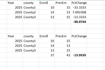

@JimMiller3 I am not sure how to fix this, they are calculating different things.  Your chart is calculating the sum of the calculated year to year percent change.   Where as the indicator is adding up all the current years enrollment and then all the previous years enrollment and the calculating the percent change from those totals  e.g.
It appears the indicator is calculating correctly, while the serial table is only calculating correctly for the selected counties and only when a single year is selected...I don't know what the solution is for this, other than being selective on what and how you show the data.  Maybe don't show percent change in the serial chart and only show current enrollment, then set a chart action to filter the indicator on selection of one of the columns in the chart.
