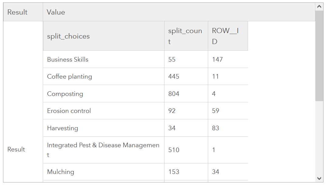

Which gives me the following:
Based on this, I can create a nice graph showing these counts, but I cannot tell the percentage of total per question. The total is easly calcuated as variable by counting the filtered result of fv_f. So I would basically like to perform per each row in the above picture an additional calculation to get the percentage.
I tried to use the GroupBy() FS I get in another for-loop but that didn't seem to work, as I am not able to reference the fields correctly, namely split_count.
Any ideas?

But to more directly address your issue, you can add another field in your GroupBy to get the percentage, by earlier calculating the total number of responses. Try this:

By using the expression 1 / @ fv_t, your GroupBy function will calculate the per-response percentage, then sum them. For example, each single response out of 2208 responses is worth about 0.000453. If 370 of my responses fall into a given category, then the total percentage of responses that chose that category would be 16.76%.
