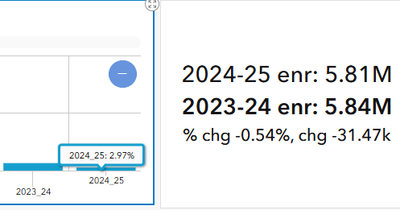

For example, the image below shows 2023-24 to 2024-25 percentage change on the serial chart and in an indicator using the percentage change calculated value. The percentage change value in the indicator card - -0.54% -- is correct. The percentage change value in the serial chart – 2.97% -- is incorrect.

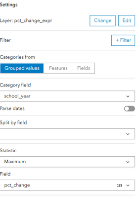

Below is how things appear in the serial chart setup. I suspect the problem stems from the Statistic selection. It currently shows “Maximum” but any option I choose – Average, Minimum, etc. -- yields incorrect values. Is there a way to show percentage change value as is, without applying a statistic type to it? Or is there another approach to take. Thanks.

@JimMiller3   Did you try "Sum" percent change? How do you have it calculated in the indicator?
JimMiller3
@Neal_t_k If I change the Statistic selection to "Sum" for the serial chart, it displays -13.53%. That is incorrect. It is the sum of the 58 counties' respective percentage changes from 2023-24 to 2024-25, and not the cumulative percentage change for the state as a whole (which is the expected value.)
The indicator works as expected: It sums up curr_enr and prev_enr values in the Data section. In the Indicator, section, I choose "Percent Change" calculated values (images below.) I get the correct percentage change whether one county, 10 counties, or no county is selected.

@JimMiller3 I am not sure how to fix this, they are calculating different things.  Your chart is calculating the sum of the calculated year to year percent change.   Where as the indicator is adding up all the current years enrollment and then all the previous years enrollment and the calculating the percent change from those totals  e.g.
It appears the indicator is calculating correctly, while the serial table is only calculating correctly for the selected counties and only when a single year is selected...I don't know what the solution is for this, other than being selective on what and how you show the data.  Maybe don't show percent change in the serial chart and only show current enrollment, then set a chart action to filter the indicator on selection of one of the columns in the chart.
