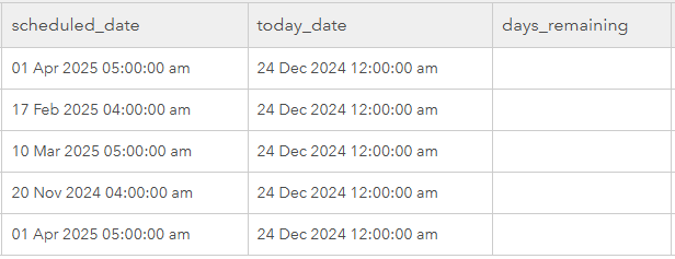

I'm creating an Arcade expression to feed a dashboard list. The expression groups on an ID to find the earliest date, then I want to find the difference between that date and todays date but DateDiff is returning blanks. I know that date formatting is picky in arcade. Its probably a formatting issue but I cannot figure it out.
Here is the code, which successfully returns a featureSet with a 'scheduled_date' and 'today_date' but 'days_remaining' is empty. I've exclude the connection steps since I know I'm successfully pulling in scheduled_date from the source.

Result:

Wrapping dates in Number() is a good idea for Data Expressions, but the function DateDiff should be given two dates. The way you have it written, you're giving it two numbers. Try just taking the number functions out.
'days_remaining': DateDiff(record['ScheduledDate'], today_date, 'days')
