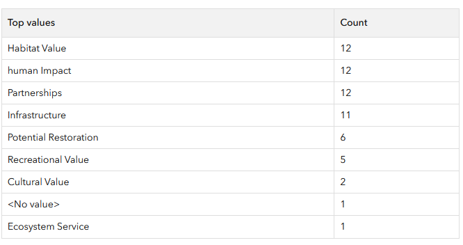

I have points that are given a primary category field and secondary category field of the same domain. I am attempting to use a pie chart to display the total count of points per category from both fields. I am trying to create a data expression to sum the count of categories from both fields:
'Comment_Type'
'Secondary_Type'

How do I get the table to use the domain label for the first column?
Why does the Secondary_Type column not match its actual values?
Is there a more efficient way of doing this?

I don't think that's possible with single GroupBy, but I'd love to be proved wrong.
You'll have to do two GroupBys, one for each field. That will give you the count for each of the fields. Then you can combine them into a single table with the counts of both and their sums
Unfortunately, the GroupBy does strip the domain information from your result. But you can add that back in when combining the tables by looping through all of the domain codes. This code loops through all the domain codes (and this assumes you're using the same domain for both fields) and filters the grouped tables to get their counts.
