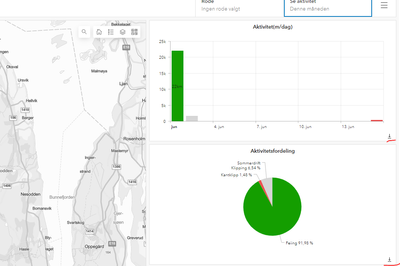

Hello,
From reading the documentation it states that the download data function in ArcGIS Dashboard only is available where the source is a, ArcGIS Online hosted feature layer.
https://doc.arcgis.com/en/dashboards/latest/create-and-share/download-data.htm
I am wondering if there is a work-around or if this will be possible if the data source is an ArcGIS Server Feature Service?
We publish a large number of services with AGS, some of them with export capabilities. These services are registered as items in ArcGIS Online and utilized in dashboards, where it would be great to have to option to export the data.
