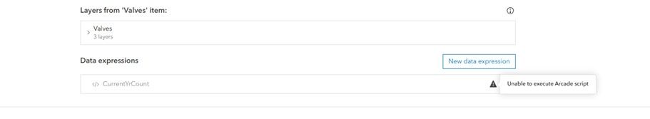

I'm trying to create a dashboard that dynamically filters data based on specific years but change when a new year rolls around without having to edit the dashboard each year.  I thought I had it figured out but cannot seem to get the dashboard to accept the use of my expression within an Indicator widget.
I have data hosted at AGOL.  We have maintenance data in a related table.  When maintenance has been performed, a new record gets added to the table with the date.  I desire to count the number of times each year maintenance has been performed.
 I've confirmed access to the data.  Without converting the data to a "FeatureSet" I get the expected value as a result but cannot get the dashboard to accept it as a data source.
I've spent more time than I care to admit trying to figure this out including trying AI and cannot seem to get it to work.  I'm obviously missing something so I'm here to hopefully gain some knowledge.

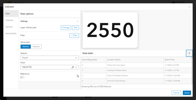

KenBuja
MVP Esteemed Contributor
This expression will filter out the records from the current year. The original dataset has 493721 records, with 2550 records for 2025
var fs = FeatureSetByPortalItem(
  Portal("https://www.arcgis.com"),
  "79461a1ec0974301bde274177c7108bd", //a layer from the Living Atlas to test
  0,
  ["place", "mag", "time"],
  false
return Filter(fs, `EXTRACT(YEAR from time) = ${Year(Now())}`); //time is the Date field
Then, in the Indicator, use the Statistic value type and Count.

tschrage
I try that verbatim using my portal information and get the generic error message: "Test execution error: Unknown Error. Verify test data."
My Date field appears to be formatted exactly like your data.  The only difference I can see is mine is located in a related table and yours is part of the base feature.
