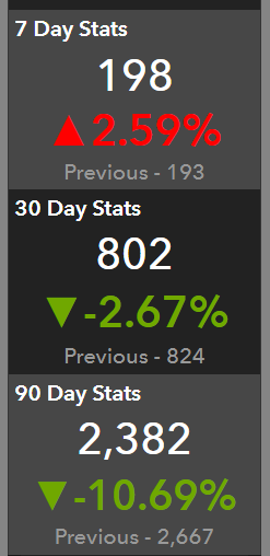

The current work around I'm doing is having a few indicators showing a predetermined time frame.....
I'm not sure if you've tried something similar but just tossing out ideas.

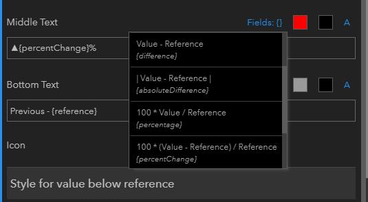

How are you getting that % value in the middle of your indicator?
by Anonymous User
Not applicable
Andrew,

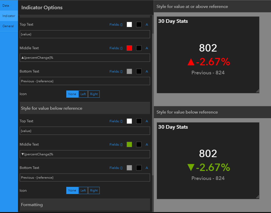

I'm creating a "Reference" that compares the previous time frame to the current (last 30 days referencing last 60 to 30 days). The option to use a reference is at the bottom of the Data pane (it took me a while to find it because I was just kind of glossing over it)/
You are given several more options in the "Fields: {}" after setting a reference
And this was the layout I decided on after playing around with it a bit.
