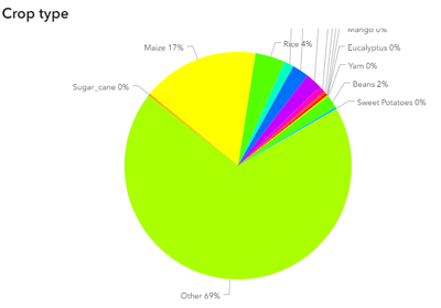

He has a survey in Survey123 which is connected to a feature layer in Enterprise. A dashboard is then built on the web map connected to that feature layer. The aim is to have all incidents in the survey visualized in a dashboard with pie charts and bar graphs responded on the map extent and date filtered. However, for the multiple choice questions, when more than one choice is selected in Survey123 the field which is created in the Enterprise feature layer contains each answer that was selected separated by commas. For example, if the question is "What crops were raided" and someone selects three different crops the answer looks like this: "Beans, Maize, Bananas". This tends to clutter the dashboard pie chart as Beans are not counted as Beans only and every list-like answer is shown as a separate slice. Even if the order in which the choices were selected changes it is seen as a separate category/slice on the pie chart (e.g. "Maize, Beans, Bananas" is a separate slice from "Beans, Maize, Bananas"). Ideally, he would want a slice for each crop type counting on the number of surveys where the crop type was selected within the list of other crop types.
He has tried playing around with data expressions and actually managed to get a table which could be counted on separate crop types, but the pie chart is no longer actionable by map extent or the date filter. Any guidance on the how to resolve this and whether this is actually possible in ArcGIS Dashboards at all, would be greatly appreciated. The pie chart under the Survey123 Analysis tab seems to be reading crop type separately, hence he believes it is an integration issue.

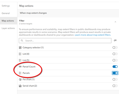

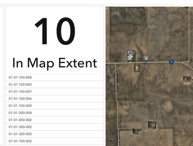

It should be possible, but it really depends on the expression. If you write the expression in such a way to include the geometry, your widgets using that expression can be acted upon by the map.
In this map, the two circled layers are from a data expression; they're not actually in the map shown.
Because the geometry is available to the layer, as I move the map, the items change:
Can you share the expression? Basically, when you're pushing your split values into the output featureset, you need to include the geometry at that point, but it depends on how you're writing your data expression.

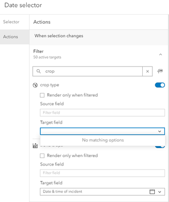

Hi Josh,
Thanks so much for the quick response. I will add the geometry field to the table and see if that works. In the meantime I had already added a field named 'date_time_of_incident' and labelled ‘Date & time of incident’ to the table being used on the visual using the data expression. The end goal is to select for date and time on the pie chart named ‘crop type’ in the dashboard. The name is the same on the selector on the dashboard but for some reason the action does not want to load the target field name (ie. looking for ‘Date & time of incident’ as in the bar chart visual below) for selection. Before I added the field name to the data expression table the visual (ie. pie chart called crop type) did not show under actions on the date selector at all so at least now it shows. This makes me skeptical about the geometry working on the map extent.
Below is the data expression which splits the multiple crops selected in the survey into separate rows. This allows each crop type to be counted using the unique fid (‘FID’ field) in the pie chart. The following fields are created {'split_choices', ‘FID’, ‘date_time_of_incident’.
