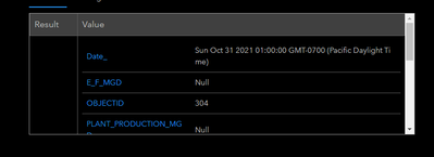

I am now getting data to display but it is still showing the Null data. How does the var filt apply to the sorted layer?

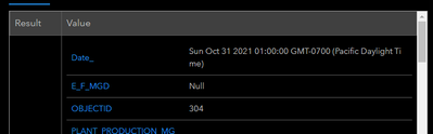

@jcarlson
Thank you for your continued help on this.
I am not sure the "AND" is the issue. I added the change and this is what I get. I think the problem is that the "filt" var is defined but then not put into the result. I would think that the "sorted" var would need to reference the "filt" var at some point.
