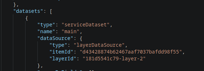

Go into the ArcGIS Assistant and open up the copy dashboard's JSON for editing. Look for the mapwidget item that refers to your map. You should be able to change the itemID being referenced.
Then go through the JSON looking for dataset arrays.
This is where you'll update the itemId of the layer datasources and their IDs.
It will likely take some trial and error, but if you know which layers are being replaced and have their itemIDs at hand, you can get your layers swapped out without needing to reconfigure all your widgets.

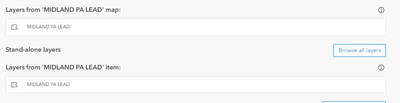

I tried replacing the itemID: in each place with ArcGIS Online assist starting with the map widget with no luck. It did bring in the web map / reference the data as seen below but all the other widgets as seen here below now broken. Any tips? I replaced the "itemID" under dataset arrays for the 7 or so times I saw the old ID replaced with new ID.
Update, after clicking one of the widgets I see my map referenced twice, one usual per map and a "standalone" ?
