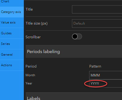

But I usually add the year to the Category Axis:
...and then train my people to understand that the Year notation is the beginning of that year, and should read it as "January".
Not pretty, but at least something is there.

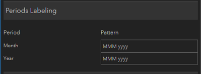

You can also add MMM yy (or any version there of) to each field and you get January to show with the year.
Result
