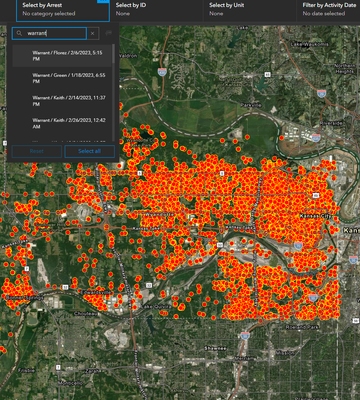

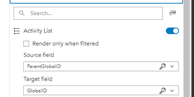

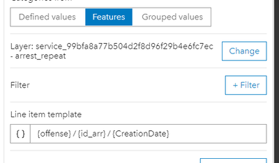

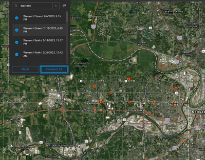

Hi Guys - The work around I found was to go ahead and use 'Features' instead of 'Grouped values'. Of course, doing so will show all of the duplicates so I added a little extra context in 'List Item Template' to make it less obvious. In the Selector section, change Selection from Single to Multiple and make sure 'Show reset and select all' is enabled. Then, in the Actions section, you have the ability to link the related table to it's parent table for the map and other widgets on the dashboard.
On the Dashboard end, I show screenshots below where the user can type in 'warrant', click on 'select all', and as expected, it selects all warrants in the arrest category and displays only those on the map.

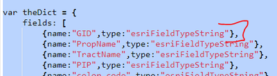

Hi all - regarding using a data expression with GlobalIDs. I found that when you use a data expression as a data source, and you want to use a GlobalID as a key to filter other elements, you need to make the field type 'esriFieldTypeString' to store it. I tried storying it as a GUID field type and it didn't work, but making it a string did. I also converted the GlobalID to text using Text(), though I don't know if it's necessary, but it worked.
