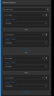

To interactively slice a date range across multiple years, you'd essentially need separate fields representing parts of the date (month, day, or maybe a single day of year, i.e 237 for Aug 1), or else you'd need to carefully define that as an option in your Date Selector.
The latter option can be extremely tedious with many ranges, and is not adjustable for the dashboard's users. If you edit the dashboard's JSON, you can quickly create lots of defined options, but the static nature of those selectors may not be what you want.

Yes, the latter one is not an option for me as it's not adjustable for the dashboard's users.

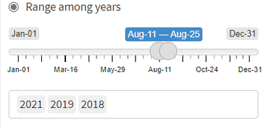

You are right that the day and year would each have to be on their own number selector. For the day number selector, it will display from 1 to 365. That is not user friendly. Instead of displaying 1 to 365, is there a way to display Jan. 1 to Dec. 31 like the screenshot below?

Could you add a coded domain to the field to associate each number with its label? I'm not sure of another way.

I tried to used a coded domain, but that did not work. The "Number Selector" only shows the numbers, not the coded values.
