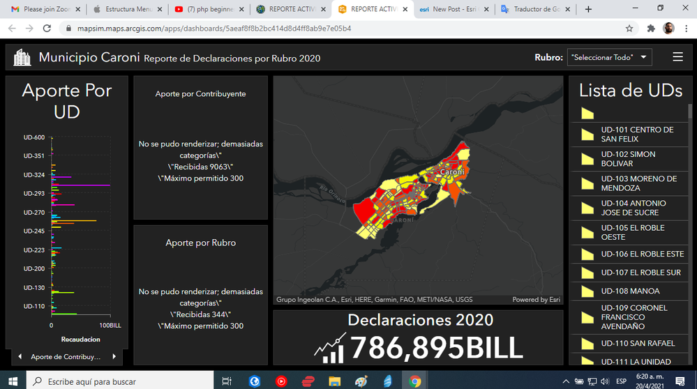

When I first configure the dashboard it works perfectly, just as you say, defining your grouping categories percentage % before selecting the target field, but a few days later it starts giving this message.
"Maximun Allowed 300"
I found a similar topic in the community : https://community.esri.com/t5/arcgis-dashboards-questions/dashboard-serial-chart-data-limit-exceeded...
