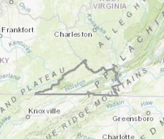

I built a dashboard that displays survey data. The dashboard map also contains shapefiles for specific areas. When i first built the dashboard I was able to filter survey results by those specific areas and zoom to them on the map. Now when the filter is selected the map zooms to the area but all of the point data from the survey disappears on the map. The information for the points located in that area still appear on the list to the left of the map and items selected from that list will appear in the embedded survey to the right of the map.
This issue appeared when the dashboard was switched over from what is now dashboard classic. I have messed with the refresh rate and other options for both the layer and the map it self. Any thoughts as to why this is occurring and what I can do to fix it.

When I zoom in and out the points still do not populate. The points populate as long as the filter is not applied. The issue only occurs when applying the filter to isolate a particular area on the map.
