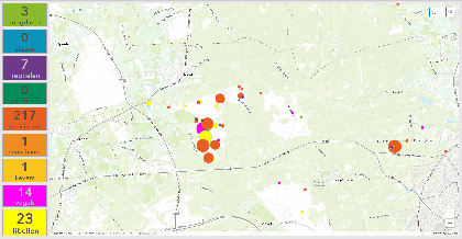

Dashboard showing (clustered) animal sightings with indicators per species:
Would it be possible to have a clickable indicator?
So as to filter the data on the map to show only that specific animal species/layer?
I know you can use the layers icon to hide/unhide the layers and this works but somehow it seems to be more intuitive to click on the indicator.
"Asking for a collegue ..." 🙂
Thanks for your time,
Bert

A 'Selector' is designed to provide this functionality. Selectors—ArcGIS Dashboards | Documentation
In this case you would create a category selector and add the indicator as a 'target' in the Actions tab.

Gisbert61
Thanks @DavidPike, I didn't come across the Selector before it being only accessible from a panel element. I also found the date Selector, great!
