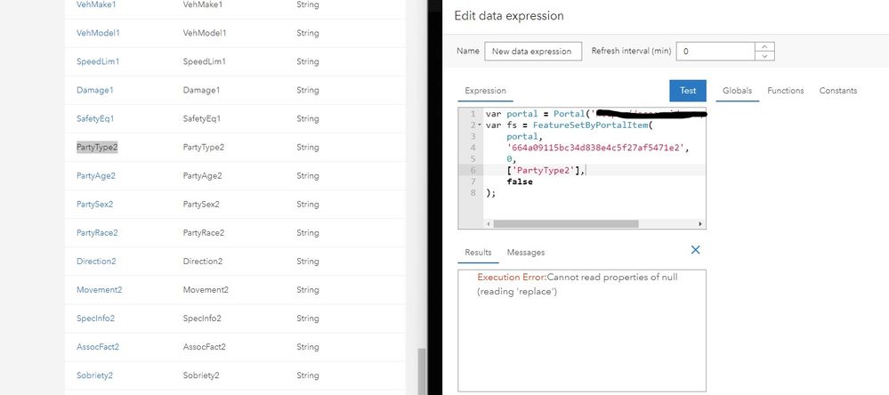

Thank you for recommendation.  So I tried creating an expression, but I am getting this error Execution Error: Cannot read properties of null (reading 'replace').

Hmmm.... I've never seen that error message before. Perhaps an Esri person would know more what that means.
