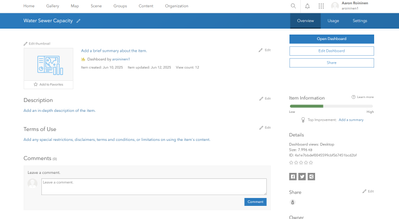

That appears to be the page for 4a1e7bbdef0045599cbf567451bcd2bf
