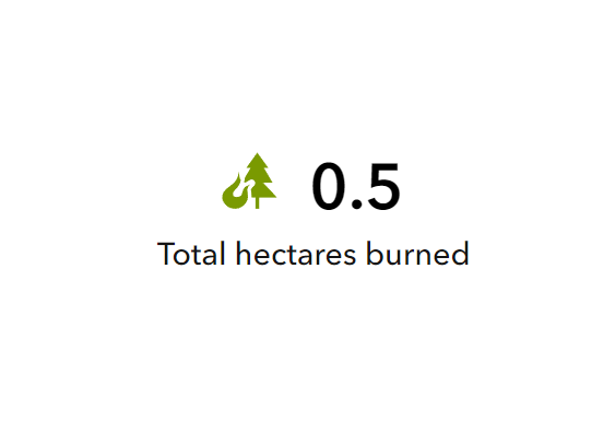

I currently have a data indicator in a dashboard that is formatted to sum the values in a specific field and show an indicator like the below:
The data being pulled for this indicator currently has no records, and by default the "no data" text appears in the indicator box. As far as I can tell, there is no way to format the "no-data" text to appear exactly like the above indicator but with a 0 in it's place.

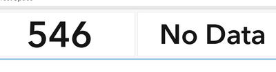

Just copy and past that HTML into your No Data formatting (be sure to click "source" first), and you'll be pretty close.
On the left, an indicator, on the right, formatted "no data" text with the above HTML.

KaitlynM
Thanks Josh,
This is super helpful and I'll probably resort to this in the interim until I have data- but I would ideally like to keep the icon and formatting of the indicator the same as it's one of many on my site.
