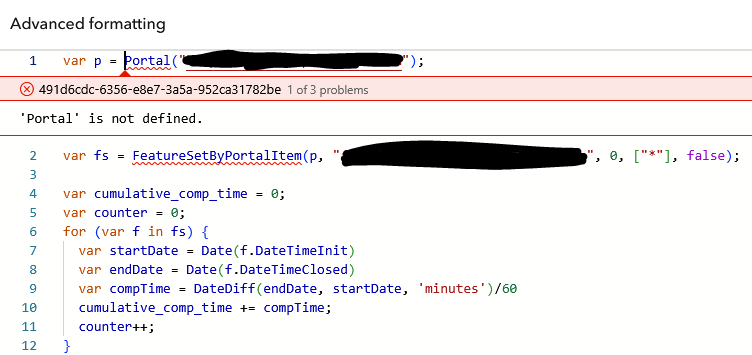

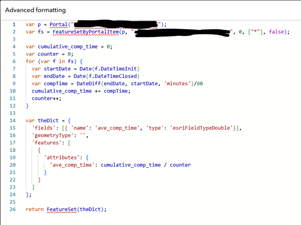

I am attempting to calculate the average completion time for a group of activities in an indicator element for a dashboard. I have a filtered dataset from our asset management system (Cityworks) in AGOL and have fields that report the start_time/completion_time. I want to calculate the average time it took to complete all the activities in the dataset. I referenced the solution found here, but keep getting errors that I cannot resolve. Here is what I have tested so far, unsuccessfully.
When I test this within the Dashboard element, I get the following error(s).

The post you referenced uses that code in a data expression to create a FeatureSet, which is used in the indicator. The profile for this functionality contains the Data access bundle, which includes the Portal and FeatureSet functions. It looks like there's a missing bundle in the documentation, since you can use the FeatureSetByPortalItem function in a data expression also.
However, you're using this code in the advanced formatting section, which doesn't include the Data access bundle in its formatting profile.

The advanced formatting tool is designed to format individual values (an indicator result or an item in a list), not calculating values from an entire featureset. What you'll need to do write a data expression for the indicator that will calculate that average. You would use your formatting function in the indicator's advanced formatting section. Your data expression would look something like this
var fs = FeatureSetByPortalItem(
  Portal("yourPortalUrl"),
  "yourItemId",
  0,
  ["DateTimeInit", "DateTimeClosed"],
  false
var responseTime = 0;
var counter = 0;
for (var f in fs) {
  var dateOpened = f.DateTimeInit;
  var dateCleared = f.DateTimeClosed;
  if (!IsEmpty(dateOpened) && !IsEmpty(dateCleared)) {
    responseTime += DateDiff(dateCleared, dateOpened, "seconds");
    counter += 1;
return FeatureSet(
    fields: [{ name: "Average", type: "esriFieldTypeInteger" }],
    features: [{ attributes: { Average: Round(responseTime / counter) } }]
