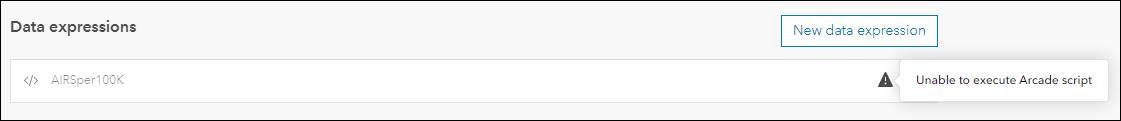

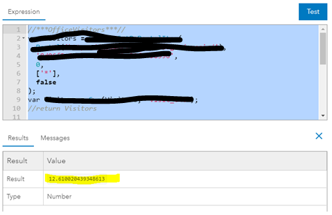

Hi, I am trying to create a simple calculation which works in the Arcade Expression, but says its unable to execute within a Dashboard Element (Indicator).
In Dashboards, I add Element > Indicator > select the 'New Data Expression' enter the code and its valid, but when i click 'Done' i get 'Unable to execute Arcade script'
