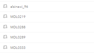

hello all,
i am looking for solution. that i have multiple layers with same field name (status). in status field i have 3 domain (completed ,not_completed,inprogress) so from each layer i want to count how many features are completed and show the total result from all layers in one widget.
the below photo show the layers
and i want to display  the total number of status=completed

You'll need to use a Data Expression. But it is absolutely possible to do what you're describing.
https://github.com/Esri/arcade-expressions/blob/master/dashboard_data/CombineMultipleLayers(SerialCh...
The linked expression works for a Serial Chart, but could just as easily be used to show a value in an Indicator.
