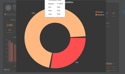

Thank you for the response, but maybe I should point out what I am talking about for further clarity:
In the hyperlink I have from the original question you can hover your mouse over an indicator in this COVID dashboard and it says 'Explore for more' (in the picture above) and then when you click on it another thing (like a pie chart or table appears that was not already appearing on the dashboard like below:
My question is is this possible to do in dashboard someway (or in another ESRI tool)? I have not seen this function on any other ESRI tool (including Experience Builder). Thanks

That dashboard you see is another web app and when you click the value in the selector, it opens that frame.

Ok, forgive me for not understanding fully, but you are saying that what i am thinking is an indicator is really a selector that when i click on the selector icon it is linking to some pie chart that is its own web app?
ABishop
MVP Alum
Yes, its linking to another dashboard with those elements and links.

Is there any further information that can be provided? When I tried to add a selector there is not any place to include embedded content, or anything that reflects the "indicators" in this hyperlink: https://business.maps.arcgis.com/apps/opsdashboard/index.html#/dc74772707d94db9a7d24d30ffdcf36c.

Could just be embedded through HTML
https://doc.arcgis.com/en/dashboards/create-and-share/effective-use-of-html.htm
