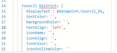

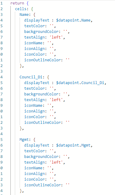

This is most likely an easy thing to do but I am new to advanced editing. How can I change the display name from Council_Di to Council District and Mgmt to Management?
I believe I need to start the begining with something like
var $datapoint.Name = ...

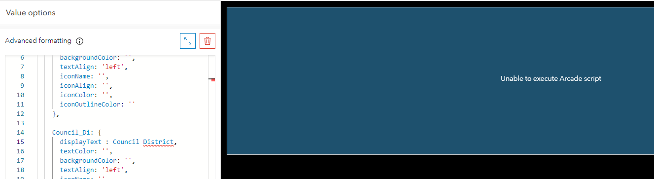

I tried changing the field name and displayText lines but when I do the table reads: Unable to execute Arcade script

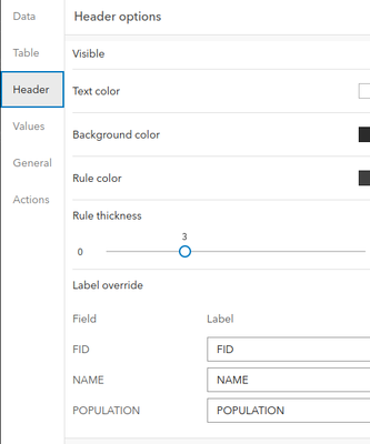

No Arcade required! You're looking for the Label override section of the settings, found in the Header tab.

dwold
Doh! I knew there was an easier way to do it! Thank you!
KenBuja
MVP Esteemed Contributor
You have to put that second attempt in quotes
displayText: 'Council District',
