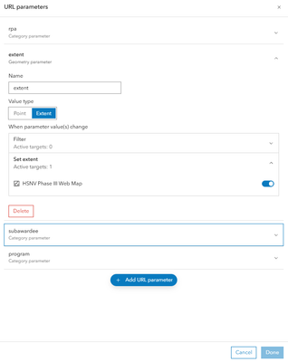

Not sure if I fully understand the issue, but the extent needs to be set up like so:
"https://osit.maps.arcgis.com/apps/dashboards/ead6daa4485542ca9cf46a4e2d5bd8a6#subawardee={subawardee_name}&program=BEAD&extent={xmin},{ymin},{xmax},{ymax}"
Extent configuration should look like this:
Not sure how long this link will work, but this is what it looks like in action.
