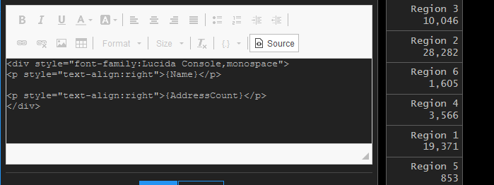

For individual widgets, you can adjust the font by editing the source and adding a style tag with font elements. I often like to set certain widgets to a monospace font to keep numbers aligned nicely.
Of course, this only works for widgets whose text can be edited in this way. Other items, such as a dashboard header or the selectors, or font within a chart, cannot be adjusted so simply.
