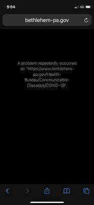

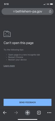

@DerekLaw , can you confirm that, while a Dashboard can be embedded in an iframe, it is not viewable on iOS devices (specifically iPhones), similar to the issues with Story Maps (https://community.esri.com/t5/classic-esri-story-maps/unexpected-story-map-behavior-desktop-vs-mobil...)?  We have a Dashboard embedded in a webpage (https://www.bethlehem-pa.gov/Health-Bureau/Communicable-Diseases/COVID-19) which can be viewed on desktop browsers and Android devices (Android 11), but not on iPhones (iOS 14) in either Safari or Chrome.

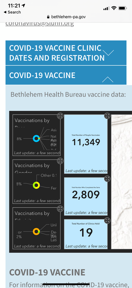

I think something is wrong with this web page outside of there being a Dashboard in it. When clicking around on the page, I am repeatably getting that error message.
I was able to see the Dashboard, so I don't think there is anything preventing the dashboard from being embedded. See screenshot below.
iPhone X
iOS  14.4
Safari
