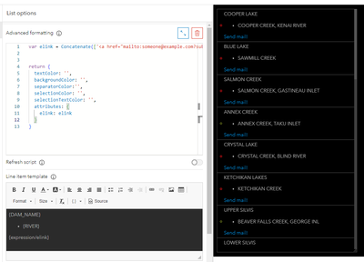

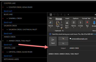

No, but you could use Arcade and HTML in a list to create a dynamic mailto link. Clicking on the link would open the user's default email program with an email already composed.
Note that you can't have any spaces, so you will want to use Arcade to URL encode your fields and use URL encoded values for any spaces or special characters you add between fields in the body or subject.
var elink = Concatenate(['<a href="mailto:someone@example.com?subject=', UrlEncode($datapoint.DAM_NAME), '&body=', UrlEncode($datapoint.DAM_NAME),'%3A%20', UrlEncode($datapoint.RIVER), '" target="_top">Send mail!</a>'])
return {
  textColor: '',
  backgroundColor: '',
  separatorColor:'',
  selectionColor: '',
  selectionTextColor: '',
  attributes: {
    elink: elink
How to create mailto links
URL Encoder
- Jen
