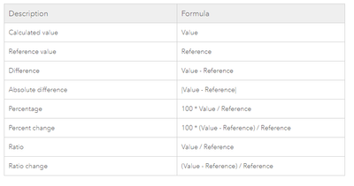

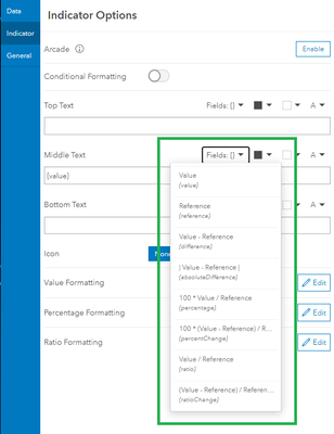

You can show percentage in an indicator by setting your numerator - in this case inoperable inspections - to your value field, and your denominator - in this case all inspections - to your reference field.
Then in your text boxes, you can display the percent by clicking "Fields: {}" and choosing 100 * Value / Reference - {percentage}. There's more information on this at Indicator—Operations Dashboard for ArcGIS | ArcGIS, including an explanation of all the other calculations that you can use within an indicator. Your percentages may show up with a lot of decimals, and you can format those by following this help: Format numbers—Operations Dashboard for ArcGIS | ArcGIS.

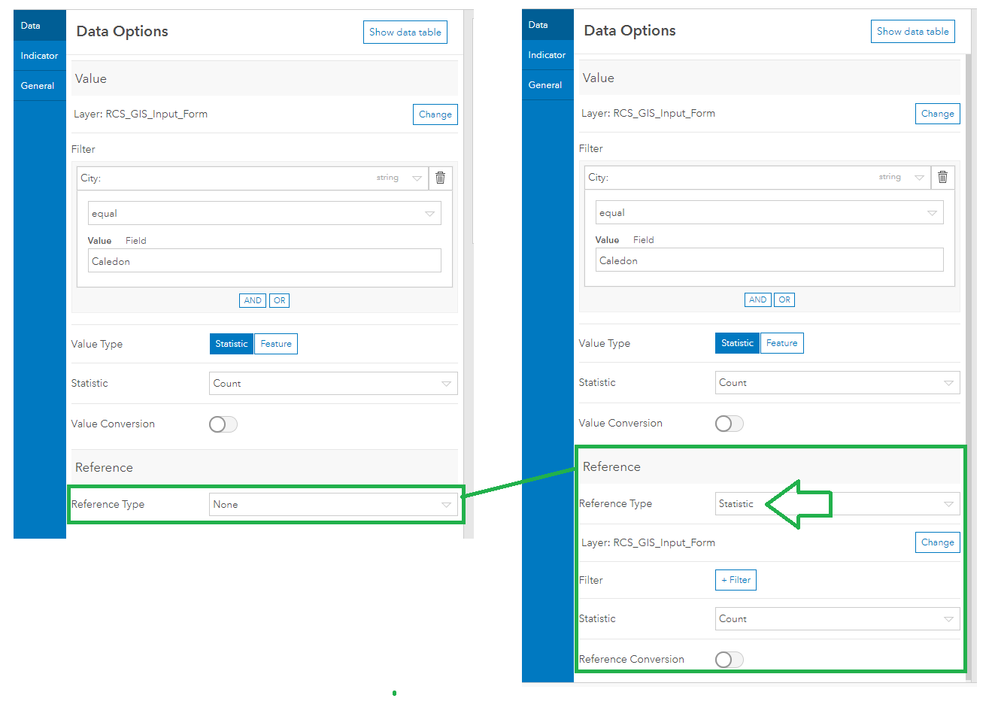

ESRI should really update the user guides on this to specifically mention that you must turn on a Reference and select Statistics for it to show up in the Fields {} of the Indicator. Pictures would be helpful as this feature is all hidden and I will be training people at work for decades on this lol.
In 2021 there are two options here that I know of:
1) Ensure that a Reference for the indicator has been set
Then the options to do the calculations show up
