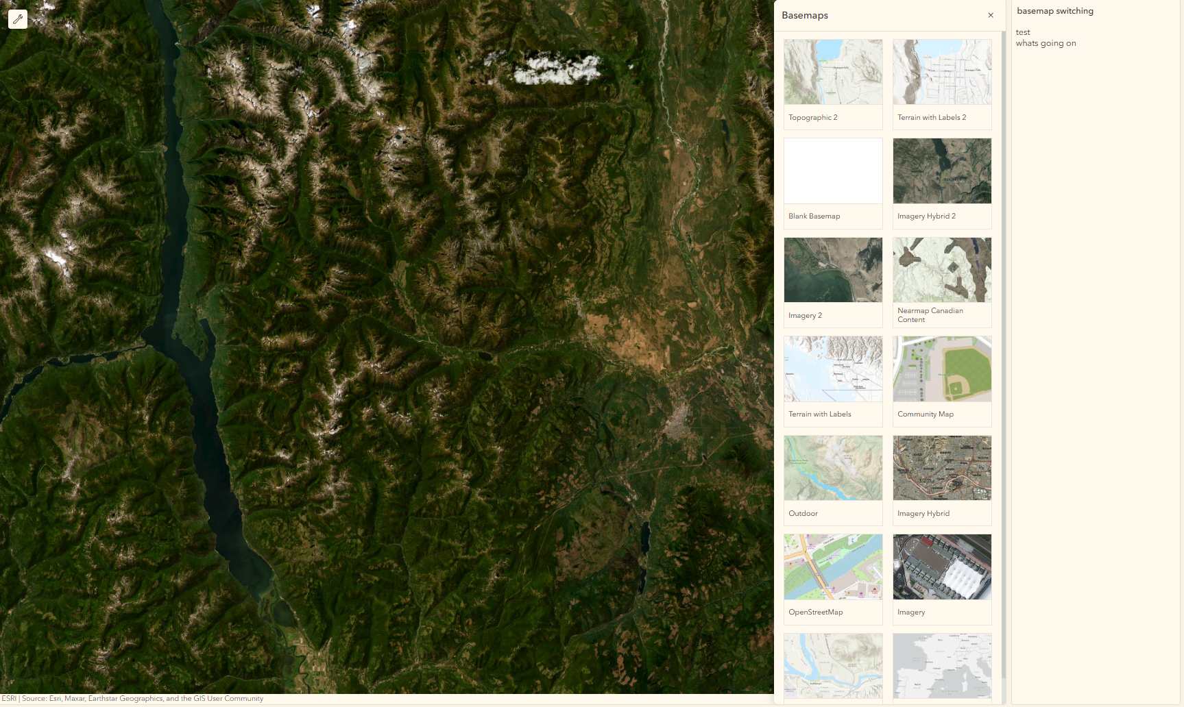

I have a dashboard built in Enterprise 11.5 that's doing odd things when switching basemaps.
When you go to switch basemaps on a map embedded in the dashboard, the panel expands with whitespace to the right of the basemap panel, obscuring the map.
Sometimes this happens the first time you switch the basemap, sometimes its the fourth time. Tried with different some webmaps/dashboard settings/arrangements of elements but same behaviour.
First time clicking on basemap switcher, looks normal.

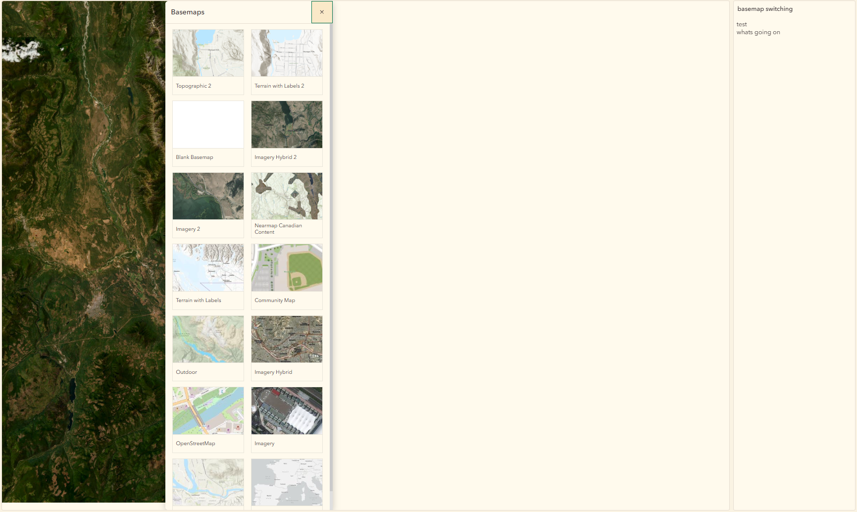

Second time clicking on basemap switcher. Panel expands with white space to the right of it.
When you click exit on the basemap panel, the white space remains. If you have element re-sizing enabled, you can sorta get rid of it by resizing the panel of an element to 'wipe' it off.
