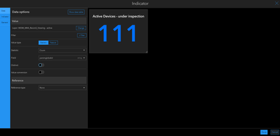

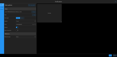

I am trying to get a distinct count on a string field and keep getting returned "no data". The count alone will work properly. I have tried on multiple layers and different fields with out luck?

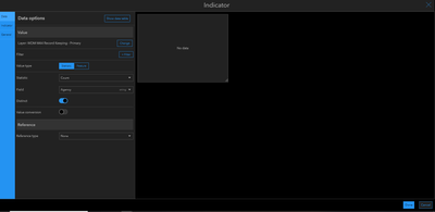

different layer:
