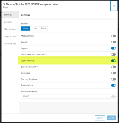

Click the three dots in the upper left corner of the map element and the gear icon to open the configuration dialog
6 Replies
KenBuja
MVP Esteemed Contributor

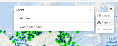

The map's Settings dialog includes a toggle for Layer visibility

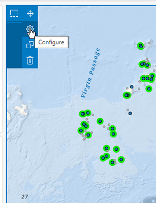

JeffSilberberg
@KenBuja
   Finally, Thank you !!!!!
