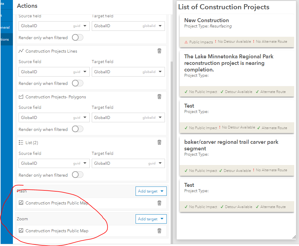

Hello ArcGIS Dashboards Team,
We've recently run into the issue where the actions from a List widget do not work on a map. The list widget (controlling the actions) is rendering an arcade expression and the Filter action does work, but the Zoom/Flash/Pan Actions do not work. This will be a public facing application, therefore we need this action functionality.
