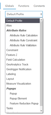

Thank you! I was trying to play in the Arcade Playground, but I couldn't understand how to reference layers in order to use the fields as Globals. What am I missing there?
jcarlson
MVP Esteemed Contributor
You have to choose a Profile, so that the playground mimics writing expressions for popups, for example, as opposed to labelling. Arcade's capabilities change depending on where it's being used.
