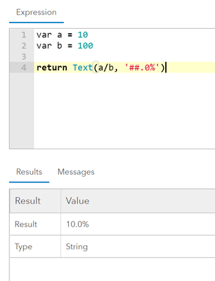

For one thing, you can output a percentage using the Text function. When your formatting string includes a "%" character, it will automatically multiply your result by 100. Including a "0" after the decimal in the formatting string ensures that the result is given to one decimal point.
Second, and more importantly, a FeatureSet has to be created from a dictionary of items that follow the FeatureSet specifications. But I don't know that you need it for this, honestly.

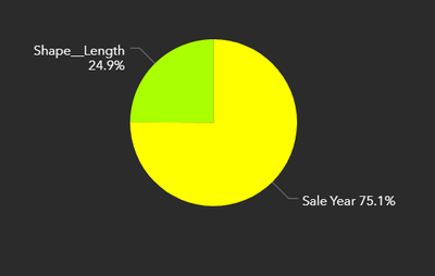

With a Pie Chart widget, you should be able to set the configuration to Fields, choose your fields, and set the statistic to Sum.
You can then adjust the percentage formatting to your requirements.
In other words, just let the chart itself handle the summing and formatting, you just need to connect it to the data.
