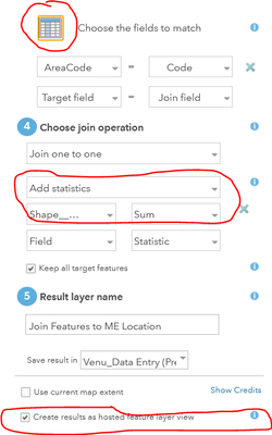

While working on something similar, where the join was not using spatial relationships but rather a relationship class, we used the "Join Features" Tool in map viewer classic. If you have a common field like a "CountryID" field, with which you can define a relationship (rather than a spatial relationship), using this tool, you should be able to generate summary statistics such as a sum. You would then use the option to export this as a feature layer (view) and then use the view layer in your dashboard.
Otherwise, I dont think dashboards can use spatial filters, but it can filter through records in different feature classes if there is a common ID field. Maybe you could just try that as well. Under "Actions" using a category selector or map, you should be able to filter using a common ID field.
