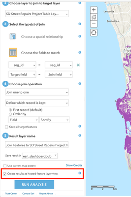

Soobin-Choi
Hi there,
Another method would be to use a field join to join the tables/layers from Map Viewer, then publishing the joined result as a feature layer view.
Credit is not required and the data will stay up to date. Depending on the size of your dataset, using data expressions to "join" tables may cause a performance lag when loading dashboard elements. This view option might be a more scalable alternative.

Soobin-Choi
Hi there,
