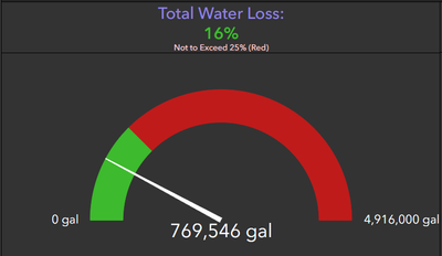

You can kind of do this using "Guides" in the Gauge settings. See my example below. It doesn't give you the option of a label on the gauge itself but you can add some text above for clarity.
